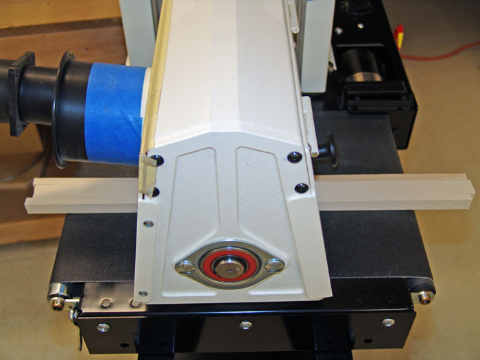

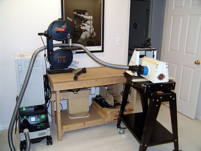

I have the Festool non anti-static 13" 2" hose running from the vac to my Performax or any of the other machines I have i.e. band saw, belt sander, small band saw.  I have 2" adapters on every machine so it's plug-and-play here at Heshtone.  When I am not using a specific machine I hang the coiled hose back on the vac.
The anti-static hoses are more money but I got away with not purchasing one on the hunch that the near constant 45% RH in my shop would negate the ability of the dust to cling to the hose - and I was correct.
All the various adapters were off the shelf at Woodcraft and Woodcraft was also handy because they had most of my machines on the floor so I could just find adapters to fit the machines there.
Here are some pics that I posted in the Festool ROS thread of my set-up.

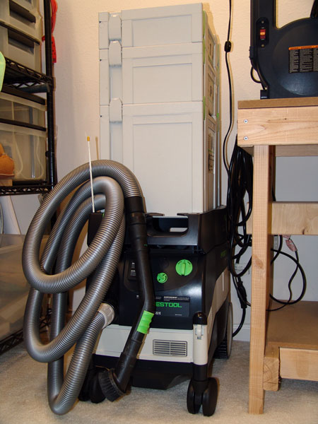

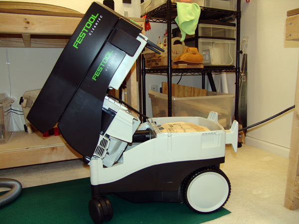

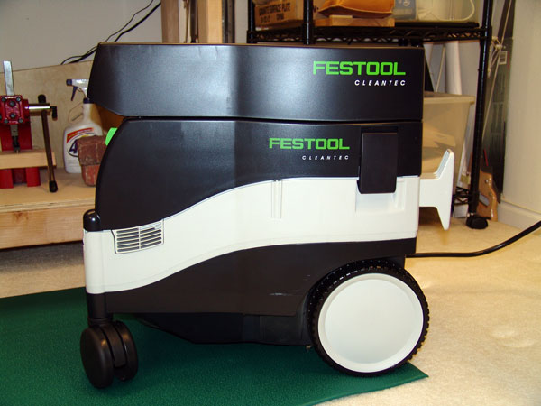

Folks I thought that some just taken pics might do a better job at explaining this than my literary prowess, or lack of same, might.
David it is a 2" hose inlet.  Smaller hoses are available and if you take the time to go to www.festoolusa.com you will see the tremendous amount of accessories that are available, in stock for these vacs.
OK - Here is how mine sits in my shop (note the 2" hose - why else would a guy be adamant about having a 2" hose and put it on the Internet if it were not true).  This means that the inlet is 2" too........
There are 4 optional things on top of the vac.  right on top of the vac is the optional hose caddy, it works great although I am not using it in this picture.  The threes boxes are the systainers which I thought were crap until I bought a tool that came with one.  You can stand on these things and they are very convenient for storage in a limited area.
Here is a side shot, note the quality wheels.  This is contractor grade equipment.

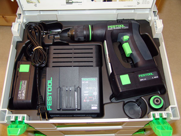

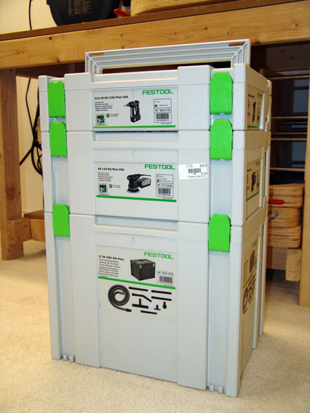

Here you see the systainers that detach from the vac, or latch back onto to it in a second or two.
This systainer came with the best cordless drill that I have ever used.
A back shot with the machine opened up.

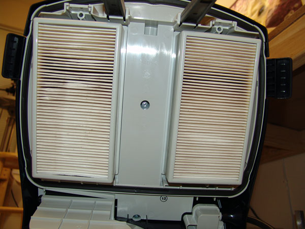

Here you can see the dual HEPA filters.  If you want to use non HEPA filters they are available from FestoolUSA too.  I changed my filters the first time after building 5 guitars but noticed no increase in performance and the old ones did not appear to be dirty.  I was just being to anal probably......
Here is the machine with the hood up.

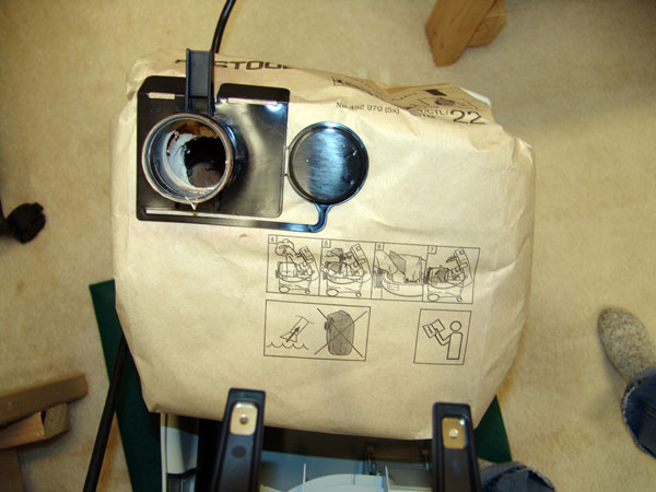

I disconnected the bag to show you the integral cap.

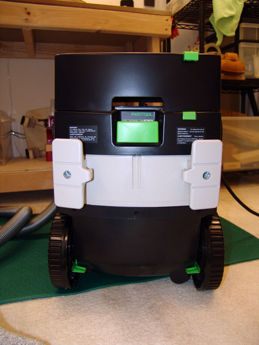

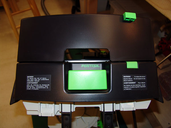

The backside.
And the clearing handle (green) on the backside.

PostPosted: Sat Nov 17, 2007 11:34 am
I actually have a ShopVac Industrial, one of the stanless steel 10 gal models.  They are 185 cfm according to specs.  I also have a dust deputy, like Rick mentioned.  The combination is unbelievable.  Since I got the Dust Deputy, I have not had to clean the filter on the Vac.  All of the fine dust and the particles stay in the cannister of the Dust Deputy, and never make it to the vacuum.  I do not have a thickness sander, but I use it with my 4x36 sander, my drill press thickness sander and Safety Planer, as well as with my band saw, and radial arm saw, plus general clean up.  I have been amazed at how efficient the Dust Deputy is.  I would recommend it highly.
PostPosted: Sat Nov 17, 2007 11:55 am
Posts: 2692
Thanks for the photos, Hesh. Very helpful. Where did you purchase the 2" hose? I have been under the impression a smaller diameter hose comes with it. And that accessories like a floor nozzle only come as kits, not single pieces.
I will not be using a shop vacuum to collect dust from any stationary machines, and probably not much for portable machines, either. I want it for vacuuming the shop floor, work tables, and the parts of machines that a central dust collection system misses. So thanks to those who gave the general dust collection advice, but my purpose is more limited.
Howard Klepper
http://www.klepperguitars.com
PostPosted: Sat Nov 17, 2007 12:05 pm
Posts: 13635
Location: Ann Arbor, Michigan
First name: Hesh
Last Name: Breakstone
City: Ann Arbor
You are very welcome Howard.
I bought the 2" X 13' hose from www.festoolusa.com and they had it to me in 2 days with standard shipping.  As Filippo pointed out the prices are the same as in the stores.  All my other accessories came from there too and the assortment of available accessories for these machines is something like 7 pages long......  Festool did an excellent job of providing all the various adapters, wands, brushes, hoses, organizers that one would ever want.
I think that the 1 inch hose did come with my machine but I bought it in a combo package with the Festool 5" ROS.  I am not sure if any hose comes with it or which hose comes with it on it's own.
OK, nix that I just checked out the Festool site and it does come with the 1" hose but I would recommend the 2" hose for use as a vac.  The 1" hose is to connect to the ROS and other Festool tools.
I also bought a kit that contained a wand, floor brush, hand wand and two hand brushes, and a crevice tool.
